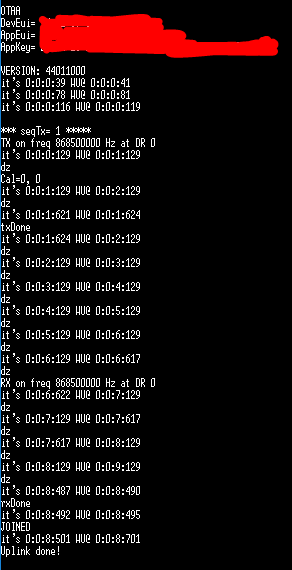

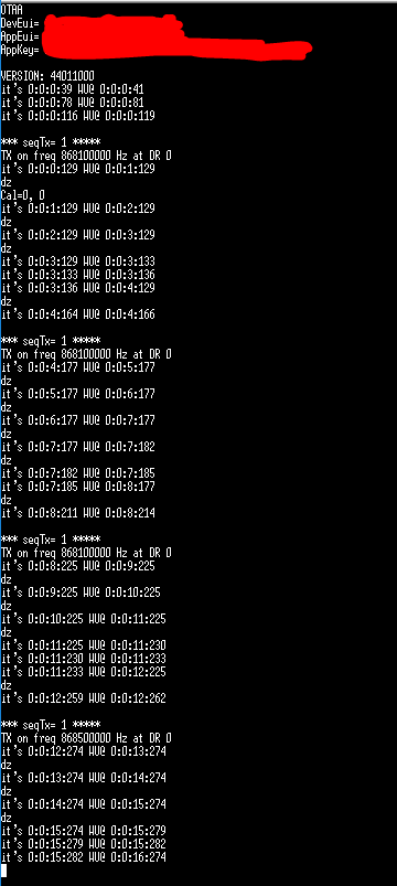

2017-05-19 8:32 AM
I made some screen about my terminal windows in debug and trace with the same code but the JP9 in a different postion:
