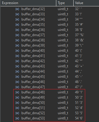

I finally broke down and borrowed some test code from my external loader development to really try to test out the external flash. Basically I erase the whole flash, load it up with 0 to 255 repeatedly throughout the memory, set it into address mapped mode and then read through the entire memory. When I did this, I didn't have any problems when reading it in software (looping through memory with a for loop and checking each byte against the expected value)...
But, if I did the same thing with DMA - I started getting mis-reads, where the read would return a byte or two ahead in memory!
This problem went away if I changed the quadspi prescaler from 2 to 0. It also works if I change SampleShifting to QSPI_SAMPLE_SHIFTING_HALFCYCLE, so I must have some sort of signal timing issue. Kinda wish I had a logic analyzer right about now.
I'm going to apply these changes to my production firmware and see what happens.

Your flash issues are puzzling still. If it is fixed by sampling at half-cycle with a pre scaler of 2, that suggests some sort of signal distortion at that speed. But you also get better results when running without the prescaler, where I would expect signal quality to be worse.
To me, it seems like it is an issue with dummy cycles or something like that, but then you should get the problem every time you initiate a new transfer, which I get is not the case?
