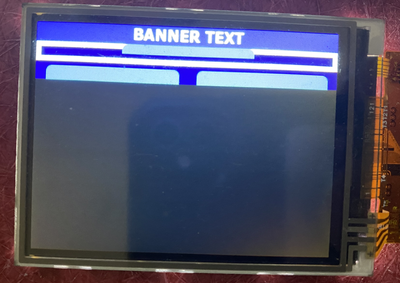

I've been trying to track down a problem I'm having with my project for several months now. Essentially I'm getting these red-ish lines through portions of my buttons, but only when (I presume) they are drawn or redrawn - namely when the screen first loads, when they are pressed, or when as in this example, they have text drawn over them that updates.
In the case of the above picture, I've been able to get the lines to appear more consistently by layering some text over top of some of the buttons and then updating that text with each tick where it says "Tick Counter: xxxx". I managed to luck out and have it appear on the "Cancel" of the cancel button this time, though it probably only happens about 1 out of 10 times when the screen loads.
These lines have been appearing pretty consistently throughout my development on the project, and they seem (though I'm still not completely sure) to be happening regardless of my application code. The reason I say this is that I've commented out large portions of my application code and had them still appear. Frustratingly, they are not consistent. I can do a build, have them appear, and then insert a trivial line of code (even a NOP), and then they will disappear, only to reappear again after I add a few more lines.
This really seems to point to some sort of issue where I'm writing off the edge of an array or something (it seems that parts of my frame buffer are getting inadvertently overwritten? But then why just buttons? And why does it still happen when I essentially remove my application code?)

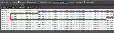

@mathiasmarkussen - I verified that the errant pixels were in the frame buffer by putting a breakpoint at the end of my transfer-framebuffer-to-display routine and then stepping the code until I saw one of the errors, and then reading out the frame buffer using the memory browser at the location that I see the artifact at:
For example:
Which I was able to determine with a little guessing to be at line 229 in my display, so in the memory browser it looks like:
0xF992 is a magenta color the same color I'm seeing on my display (and checking the rest of the colors before and after, they are also consistent with what I'm seeing on the display as well):

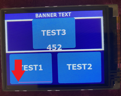

Thanks for that observation. I'm definitely getting artifacts over the buttons in where I invalidate that centrally located text area, but your absolutely right, the one I picked to show what I was seeing didn't have any text over it, although the whole purpose of the text area drawing over the buttons was to force invalidation and try and make the artifacts show up more consistently so that they could be easily detected when they happen.

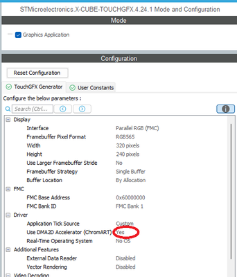

That is odd. I'm back to some sort of buffering issue. TouchGFX can use DMA2D to fetch the bitmap in extflash and copy it to the framebuffer. I can see you have that turned off in your TouchGFX configuration. What happens if you turn that on?
2025-01-31 5:41 AM
Are you referring to changing this parameter?
Without changing anything else, this happens:
I hadn't seen this issue before, but the reason I had been keeping that setting off was because when I turned it on, I was getting this: Trying to setup DMA2D with TouchGFX and an FMC con... - STMicroelectronics Community
