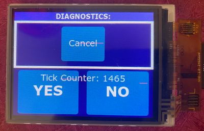

I've been trying to track down a problem I'm having with my project for several months now. Essentially I'm getting these red-ish lines through portions of my buttons, but only when (I presume) they are drawn or redrawn - namely when the screen first loads, when they are pressed, or when as in this example, they have text drawn over them that updates.
In the case of the above picture, I've been able to get the lines to appear more consistently by layering some text over top of some of the buttons and then updating that text with each tick where it says "Tick Counter: xxxx". I managed to luck out and have it appear on the "Cancel" of the cancel button this time, though it probably only happens about 1 out of 10 times when the screen loads.
These lines have been appearing pretty consistently throughout my development on the project, and they seem (though I'm still not completely sure) to be happening regardless of my application code. The reason I say this is that I've commented out large portions of my application code and had them still appear. Frustratingly, they are not consistent. I can do a build, have them appear, and then insert a trivial line of code (even a NOP), and then they will disappear, only to reappear again after I add a few more lines.
This really seems to point to some sort of issue where I'm writing off the edge of an array or something (it seems that parts of my frame buffer are getting inadvertently overwritten? But then why just buttons? And why does it still happen when I essentially remove my application code?)

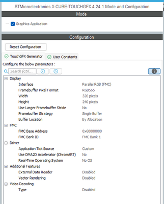

Touch GFX Configuration:

On additional thing I just noticed - if I set the button's alpha value to 254 or less, instead of 255, I don't seem to get the artifacts. I don't know how this factors into the problem, but figured I would mention it.

One further note, my second post about the alpha value appears to have been yet another 'red herring', Further testing seems to indicate that changing the alpha value did not really have any effect on the presence or absence of these artifacts.

@JTP1 The bars do go away when I force everything onto the internal flash - unfortunately this doesn't mean much at the moment, as even small changes in unrelated code causes these lines to come and go from build to build. I certainly am open to examining my quadspi code further, though I'm not sure what I would be looking for.

I'm currently testing my code with a simple screen with 3 buttons and a text area that is drawn such that in overlaps with all three buttons (I've attached a video showing what it looks like running):
I'm invalidating the "Test Text Area" with every tick.
