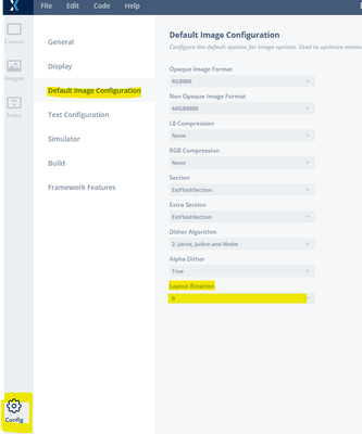

2026-01-21 4:17 AM
Hi Andi,
Happy to hear that you were able to find the issue :)
For the image rotation, each image can have its layout rotation parameter configured here:
If you select "default", it will use the layout rotation set in the default image configuration window:
