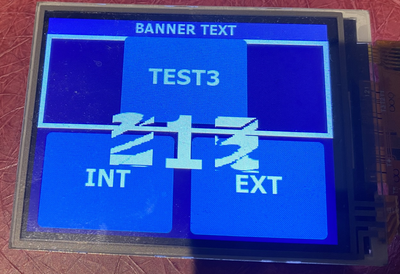

Well, I should have tested the larger font size (Size 80, Verdana Bold) because that still has the problem I mentioned before:
When I disable ChromArt under the TouchGFX settings these weird character distortions go away.

Is that a static text or a number that increments? Are the artifacts consistent; in this case the 1 is correct, are all 1s correct? Are all 2s broken in exactly the same way?

The text is dynamic - I was updating it with every tick, mainly to force invalidations for those buttons and "stress test" the system. I just changed my code to increment the counter manually so that I could go through each digit manually.
void ArtifactTestScreenView::vfYesButton() { // Lower Left button
textPrompt.invalidate();
void ArtifactTestScreenView::vfNoButton() { // Lower right button
counter++;
Unicode::snprintf(textPromptBuffer, TEXTPROMPT_SIZE, "%d", counter);
}The following digits are scrambled (and always in the same way as far as I can tell): 2, 3, 5, 6, 7, 9. The rest of the numbers seem to be ok (0, 1, 4, 8). I've included a video so that you can see it happen as I press the buttons (sorry the video is turned sideways)
What is interesting is that as it repaints the portion of the digit for the button depressed image, it seems to do it correctly, but as soon as I release the button, it goes back to garbage.

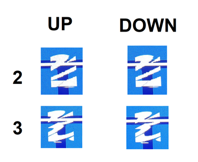

}First, it would be interesting to see if the scrambled letters are the same when counting up and counting down, I'm wondering whether it's the number being drawn incorrectly, or if there is somehow a part of the previous number remaining.
The lines with comments just invalidate the entire display, i wonder if that shows the entire number correctly.
2025-02-04 5:26 AM
Yes, thank you for that suggestion. I do plan to move to interrupt based processing of the screen transfers, but I wanted to keep things simple for debugging these issues for now, and even with blocking code, I still see at least a 10x performance improvement over the for-loop (CPU) transfer of data to the display.
Counting up or down to the errant numbers does not seem to make a difference:
Uncommenting the additional invalidate statement at the end does not appear to have any effect.
