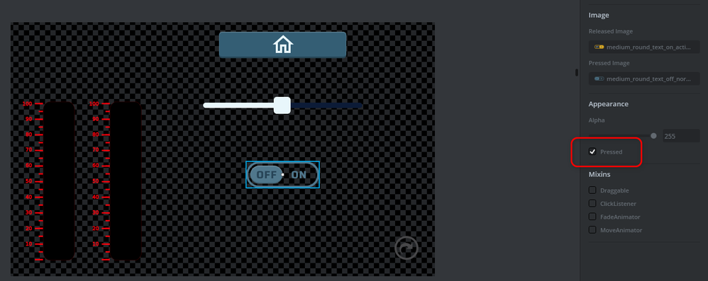

2025-02-23 4:09 AM
Hello TIF,
I also had this question at some point and resolved it by checking the box in the designer to set the state to "Pressed". This is a bit confusing because in my mind I wanted the toggle to be off, and pressed implies on. (confused emoji)
