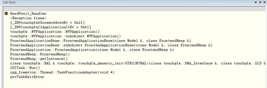

Depending on how we configure the CRC module, we seem to run into some hardfault from within the TouchGFX initialization.

Sorry, i'm not sure how i missed this. The trace you presented seems to be during startup of the application.
What exactly are you doing with the CRC engine that caused the lock to stop functioning? Are you using the CRC before or after TouchGFX starts? etc. Thanks!

yes, the screenshot was taken when the app crased on startup. We are not sure what causes this crashes.
