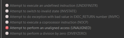

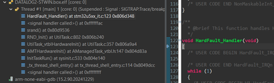

The board operates correctly until it is reset. After reset, I encounter multiple faults, including:
  • HardFaults
  • Bus faults
  • Memory management faults
  • Usage faults (forced)
  • Precise data access violations
  • Occasional unaligned access faults
(See attached screenshots for details.)
