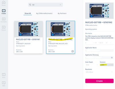

Hello @Ivans91 ,
You can use X-Cube-display for ILI9341, this is what we use for the Nucleo-G071RB + GFX01M2 TBS (Interface selected in STM32CubeMX is: Custom).
I invite you to look at what we have done on this TBS and try to replicate the same (you need to use version 3.0.5 of our TBS).
