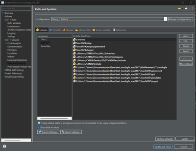

It looks like STM32CubeMX is creating the correct folder structure.
Now I'm getting 64 fatal errors.

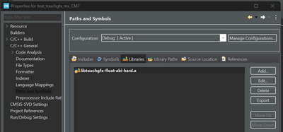

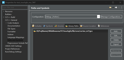

I also tried generating a TouchGFX GUI code, and now I'm getting this error.
I tried solving it as described here: https://community.st.com/t5/stm32-mcus-touchgfx-and-gui/cannot-build-project-with-cubeide-undefined-reference-to/td-p/699214
The project has already been converted to C++.
I have also added all the Folder
I keep getting the same errors. I would really appreciate any help. Thank you very much.
