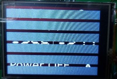

I tryed to follow the G071 example code. The LCD is up and working and i'm able to fill it with color before the GUI starts. But after that i'm facing this on my display and can't figure out where is the problem.
It's looks like the framework doesn't sending the whole blocks and after a few lines it's stops till next transmition.

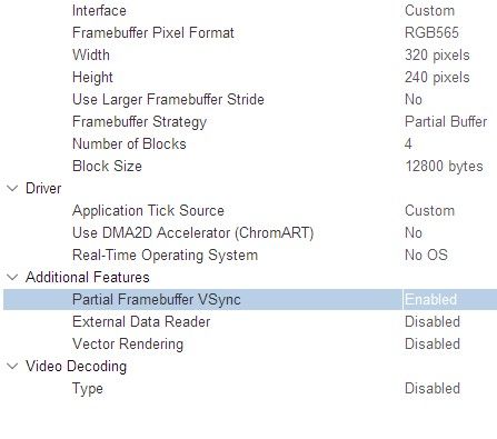

For this i disabled the parameter in CubeMX

}by this i have to invalidate the whole screen every time for any changes and the last block of old framebuffer data will be visible very shortly. Please find the atteched video

In your video, we see artefacts of the upper half on the bottom half. The video last 4 seconds and we see the artefacts 6 times in total. The artefacts shows at repeated timings.
If your tick timer is meant to be "shot" 120 times per seconds, since you have a 90 ticks cycle, the artefact and the rising/falling edge would be in phase so we would be almost sure that it happens every time you refresh your screen.
In that case, you refresh your screen quite rarely (around 1,3 frames per second).
