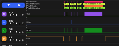

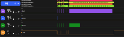

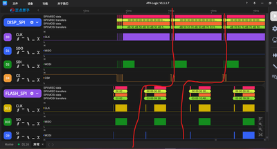

}I code as above,but the screen displays black line:
I'm not sure whether my

2026-02-17 1:11 AM - edited 2026-02-17 1:27 AM
extern SPI_HandleTypeDef hspi2;
volatile uint8_t isReceivingData = 0;
void DataReader_WaitForReceiveDone(void)
while(isReceivingData)
void DataReader_ReadData(uint32_t address24, uint8_t* buffer, uint32_t length)
uint8_t cmd[4];
cmd[0] = CMD_READ;
cmd[1] = (address24 >> 16) & 0xFF;
cmd[2] = (address24 >> 8) & 0xFF;
cmd[3] = address24 & 0xFF;
HAL_GPIO_WritePin(FLASH_CS_GPIO_Port, FLASH_CS_Pin, GPIO_PIN_RESET);
HAL_SPI_Transmit(&hspi2, cmd, 4, HAL_MAX_DELAY);
HAL_SPI_Receive(&hspi2, buffer, length, HAL_MAX_DELAY);
HAL_GPIO_WritePin(FLASH_CS_GPIO_Port, FLASH_CS_Pin, GPIO_PIN_SET);
void DataReader_StartDMAReadData(uint32_t address24, uint8_t* buffer, uint32_t length)
isReceivingData = 1;
//Blocked receiving version
//isReceivingData = 1;
uint8_t cmd[4];
cmd[0] = CMD_READ;
HAL_SPI_Receive_DMA(&hspi2, buffer, length);
//HAL_SPI_Receive(&hspi2, buffer, length, HAL_MAX_DELAY);
//HAL_GPIO_WritePin(FLASH_CS_GPIO_Port, FLASH_CS_Pin, GPIO_PIN_SET);
//isReceivingData = 0;
void HAL_SPI_RxCpltCallback(SPI_HandleTypeDef *hspi)
if (hspi == &hspi2)
}I found the reason. I was too careless. My SPI FLASH driver DMA receiving code does not set the receiving flag isReceivingData. In this way, every call to DataReader_WaitForReceiveDone after receiving flash data once through DataReader_StartDMAReadData will return immediately. The following is the correct code:

2026-02-16 6:11 AM
Thank you for your reply.
The first two codes are my hal version code.

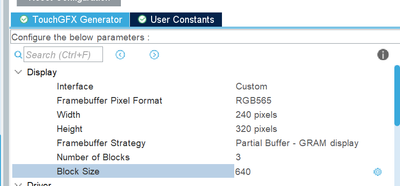

When I adjusted the Block Size from 2048 to 640, the black stripes disappeared.
And the waveform is as follows:

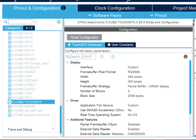

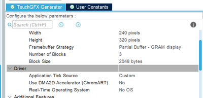

When I adjusted the Block Size from 640 to 2048, the black stripes appeared.
This is the transmission waveform after this function call.
HAL_SPI_Transmit_DMAMOSI data disappears in the second half of CLK line, but the clock is still running. I suspect there is something wrong with my dma transmission code.
Is there a sample project related to HAL version? I think I can learn from it.

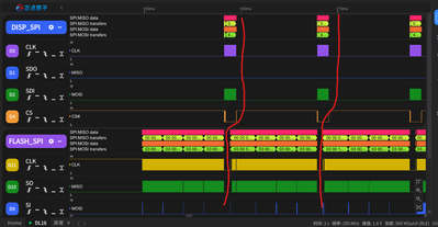

2026-02-16 10:04 PM
The first picture is problematic and the second picture is normal.
I changed the SPI FLASH driver function DataReader_StartDMAReadData to the blocking receiving version, and everything is normal. The code is as follows:

But I don't understand why there is a problem with my DMA receiving version. When I use DMA receiving mode, I can see from the waveform diagram that I will only read from FLASH once, that is, one line of pixel data. But normally it should be read four times, that is, four rows of pixel data. So when I use DMA to receive the version, the MOSI of DISP_SPI will be 0 after sending one line of pixel data, which is why the MOSI on the waveform chart remains zero in the second half, which is why the black line appears.The code of DMA receiving version and my TouchGFX configuration are as follows.
