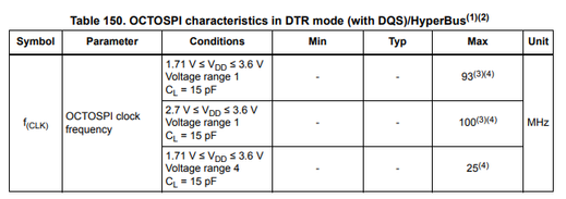

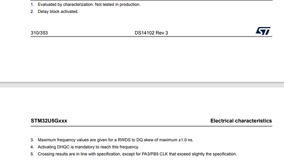

Hello @IAnastasopoulos and welcome to the community;
First of all I apologize for my late reply.
Could you please try to decrease the OCTOSPI clock frequency.
The max OCTOSPI clock frequency for STM32U5G is 100 MHz
I hope this help you.
Thank you.

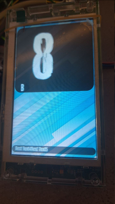

2025-04-18 10:06 AM
Based on linker fonts isnt in QSPI and based on my design U599 with simmilar issues and no QSPI at all i mean no relevant to QSPI.
Then i ask too same. Next info from my design i dont use vector fonts and see same random glitches. Seem GPU2D render have some issue.

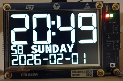

2026-02-18 2:19 PM
Just by the way I'm using opensource library stb_truetype.
I understand it's maybe a palliative solution but it work. Library exists in only one file: "stb_truetype.h" is downloaded from here:
https://github.com/nothings/stb
And example how I used this is here:
https://github.com/wegi1/STM32U5G9J-DK2-RTC
