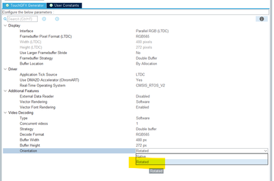

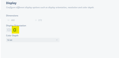

2025-10-03 7:01 AM
Hello @gerthmar ,
The rotated video is indeed something we implemented on TouchGFX 4.25.0.
2 things are needed to use it :
With these 2 changes it should be working.
