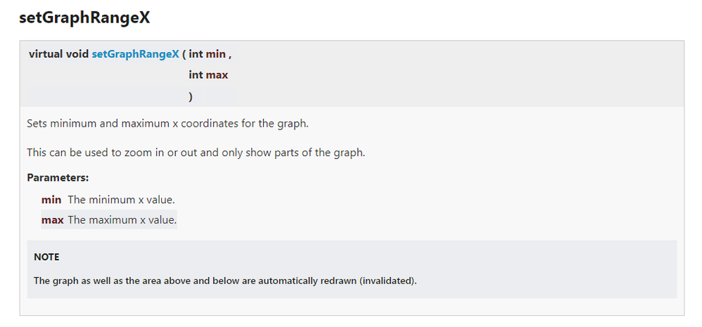

I use the setGraphRangeX(int min, int max) function for this.
However, when I get down to 1 bar with setGraphRangeX(0, 0) I get an error during execution.

I think there is also a setGraphRangeX() method with float xmin and xmax parameters.
What if you try to use setGraphRangeX(0, 0.5) or something similar ?

setGraphRangeX(0, 0) does mean that you wanna display data between xmin = 0 and xmax = 0 :
So it means that you are basically showing nothing. If you wanna display only the first bar, I guess it should be setGraphRangeX(0, 1) instead.
