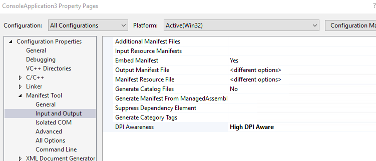

In Visual studio 2022 I've disabled the windows scaling like so:
This renders the simulator at native resolution. So the window can be quite small.
In order to do integer scaling I've added SDL_SCALE and modified SDL hal. I've modified my HALSDL2.cpp file like so:

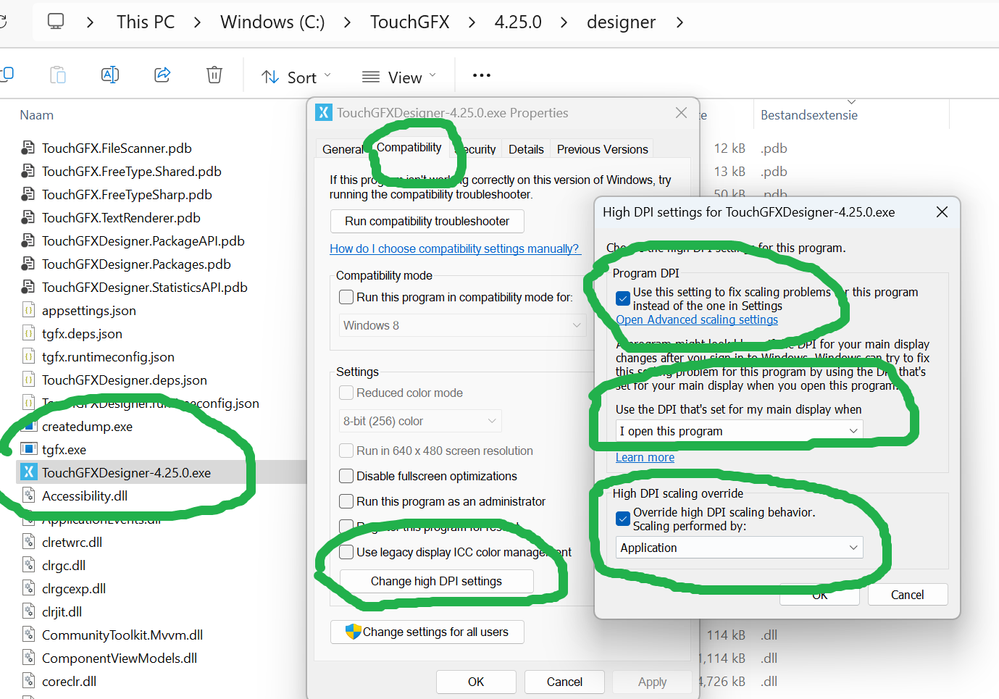

Additionally I would like scaling for designer to be fixed too. With my previously shared workaround the simulator window works, but the render in the preview in the designer does not, it looks blurry.
I have a workaround for that too:
Right click the application (in this case C:\TouchGFX\4.25.0\designer\TouchGFXDesigner-4.25.0.exe)
Select Properties->Compatibility->Change high DPI settings->
Now the application will remember the scaling settings until you restart it.
