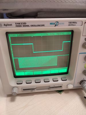

I can observe the following with my scope:
The first picture shows the clock signal of the burst and the BUSY signal. As expected, BUSY is pulled LOW before the data burst and pushed HIGH after.

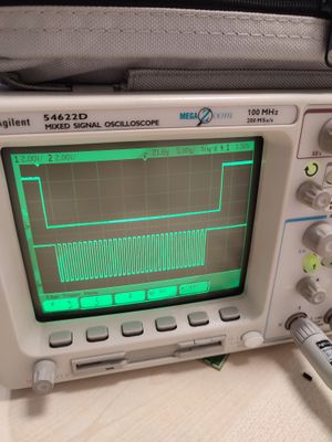

The second picture shows the clock signal of the burst and the TIMDBG signal. As expected, the TIMDBG signal is pushed HIGH right after data burst (caused by rising edge of BUSY signal). However TIMDBG doesnt stay high for the entire dataframe, but goes LOW after a few bits. This means, that my receive complete callback is called before receiving the complete package. So I have to assume that my data is corrupted. Why is that? Do you have any troubleshooting tips how I can find the reason for this early callback call? Are thres ome other interrupts I have to exclude?
P. S.: One might think the observed behaviour might result from the short time between the end of the databurst and the rising edge of the burst signal. I already tried to start the conversation not by the rising edge of the BUSY signal, but by some timer or other ressource. Unfortunately, this didn't had any effect on when my callback routine is called.

The SPI has a 4-byte RXFIFO which may be keeping data and preventing you from resyncing. If it starts out of sync, it will remain that way.
Where you do TIMDBG_START, also read out the contents of the RXFIFO so that it starts from empty when the call happens. Something like this.
spi_handle.Instance->DR;
HAL_SPI_Receive_DMA(&spi_handle, spi_data, LTC2440_FRAMESIZE);

We're lacking information on what TIMDBG_START/TIMDBG_STOP is doing. Which one sets it high and which one sets it low?
Looks like TIMDBG_START happens due to EXTI but we are lacking information how this EXTI is configured and what is triggering it.

Sorry for missing information. The macros TIMDBG_START/TIMDBG_STOP are defined as
#define TIMDBG_START HAL_GPIO_WritePin(TIMDBG_GPIO_Port, TIMDBG_Pin, GPIO_PIN_SET)
#define TIMDBG_STOP HAL_GPIO_WritePin(TIMDBG_GPIO_Port, TIMDBG_Pin, GPIO_PIN_RESET)They just set an unused GPIO pin HIGH or LOW, so that I can see on my scope when the interrupts are happen.
Yes. TIMDBG_START does happen after an external interrupt. I have configured the pin on the BUSY signal as External Interrupt Mode with Rising edge trigger detection (and Pull-Up enabled).
