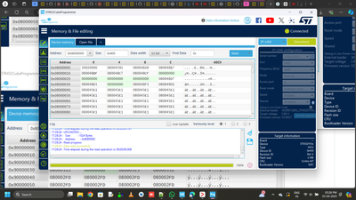

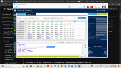

No, I didn't manage to make it work. I compressed the image as much as possible to fit it into internal flash, but I still need external memory to store additional data. Today, I realized a few reasons why I was unable to work with NOR flash. I discovered that my external loader was not created properly because I only tested full chip erase and assumed the loader was fine. I followed a guide and finally got the LED to blink, which is how I tested read and write operations before using the loader. Then, I modified only the loader_src.c file from a GitHub project for the NOR flash used in the evaluation board (M29W128GL), changing the size and name to create a loader for my NOR flash (MT28W01ABA). With this loader, I was able to read, write, and perform a full chip erase, but not a sector erase. finally, got error before debug as data is mismatched like 0xff instead 0xe1..(pic attached).. should I create a each and every step as said here, but this is for qspi.? did anyone followed this for fmc_norflash..? Should I use IAR or CubeIDE? How do I handle FMC-based flash rather than QSPI?
