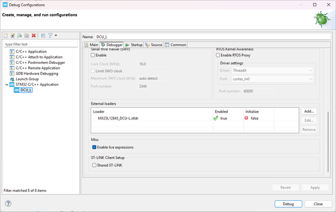

Not sure if this will help, but when You can programm the External Flash via CubeProgrammer, You have a working external loader for your flash. You have to tell the CubeIDE to use this Loader by selecting it in the Debug Configuration::
2026-02-11 2:21 AM - edited 2026-02-11 2:21 AM

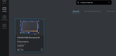

Another question, why are you configuring QSPI and other stuff while you can start your project from TouchGFX Designer based on TBS board (STM32H750B-DK board) that it will configure all the stuff for you including the QSPI interface?
2026-02-11 9:48 AM
Thank you, this is exactly how I started TouchGFX Designer -> generate code -> open files -> STM32CubeIDE Folder -> open ioc -> configure the rcc, set the rtc timer, and adjust the clock source ->save -> generate code -> open IDE -> build -> debug -> Fail
