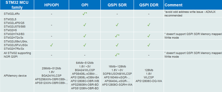

There are definitely some issues with some STM32H7 devices and some APS memory. Perhaps @Alex - APMemory can weigh in. There is a spreadsheet but it's incredibly hard to find by searching. Ahh, here it is:
Re: H723 - OCTOSPI: device's page size and wrap se... - STMicroelectronics Community
Related:
Memories compatible with QUADSPI, OCTOSPI, HSPI, a... - STMicroelectronics Community

Thank you so much for the reply! I will definitely go through it right away to verify if my specific STM32H7 and AP Memory combo falls under any known silicon errata or incompatibility.
