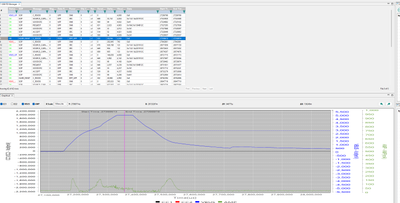

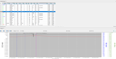

2026-05-19 10:20 AM
@JoeMck Would you attach your trace and voltage of CCx and VBUS.
2026-05-19 12:26 PM
The top one is scaled to see VBUS, the bottom to see CC.
