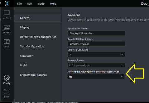

Dear Gfx Team,
1. Could you please consider adding project setting to automatically delete ./touchgfx folder when Designer exits or project closed (Ctrl+Q) ?
The folder's size is nearing 300Mb. I have tried many Designer Examples and they consume a lot of disk space because of ./touchgfx folder.
This would mirror auto copy of the "./touchgfx" folder into project if not present.
Something like this:
2. Idealy, option to set to auto delete "./simulator/msvs/.vs" folder as well would great as it is often even bigger than ./touchgfx.
Thank you.

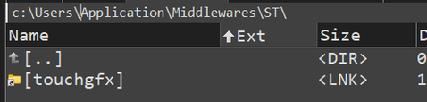

2026-02-11 7:55 AM - edited 2026-02-11 8:25 AM
On Windows, you can create a directory junction (also called a soft link)
Navigate to your project folder Middlewares\ST\. Delete touchgfx folder and run following in command line (need to be admin)
mklink /D "%cd%/touchgfx" "c:\TouchGFX\4.24.1\touchgfx\"
