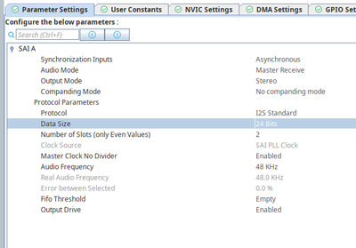

next...SAI settings:
show your..., is output drive set ?

Thanks again for your guidance. I followed your suggestions about enabling callbacks and disabling ICACHE, which allowed the debugger to work. I also reviewed the SAI settings.
I tried configuring SAI B based on your example parameters, ensuring Output Drive is Enabled. Here is a screenshot of my current settings:
Key settings in this configuration:
Protocol: I2S Standard
Data Size: 24 Bits
Master Clock No Divider: Enabled
Audio Frequency (Target): 48 KHz (Note: Changed from 16 KHz in earlier tests)
Fifo Threshold: Empty (Still set to Empty based on your screenshot example, maybe this is wrong for Receiver?)
Output Drive: Enabled
Results with this configuration:
The DMA callbacks (HAL_SAI_RxHalfCpltCallback and HAL_SAI_RxCpltCallback) are still not being triggered. My counters inside remain zero.
Oscilloscope: I probed the SAI pins:
SCK (PE12): Shows a clock signal (frequency corresponds to 48 KHz target and settings).
WS (PE13): Shows a frame select signal (48 KHz).
SD (PE11): Shows data activity from the microphone.
Remaining Issue:
Even though the clocks are generated and the microphone is sending data, the DMA interrupts are not firing.
Could the Fifo Threshold setting being Empty be incorrect for Master Receive mode? Should it be Half Full instead?
Also, in the CubeMX Clock Configuration tab, although I target 48 KHz, the Real Audio Frequency shows 0.
Any further advice, especially regarding the Fifo Threshold setting for receiver mode, would be greatly appreciated.
Thank you!

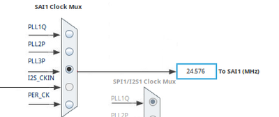

2025-10-23 10:17 AM
So on H7S3 , SAI shows:
with clock setting for SAI:
+ try setting stereo...as i dont know, what "mono" doing with 2 channels (I2S is basically always 2 ch, L+R ).
+ try fifo..half, if you like; it will not explode...just 30 sec and you know.

>verified the `SAI Kernel Clock` is ~2MHz
Whats the `SAI Kernel Clock` ? the 24M i have for SAI ?
because
shows: the SAI clock much to low, try as i do, to set it to 24.xx M .
-> Real Audio Frequency should show, what you get.
Now you get .... 0.

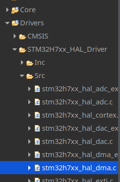

2025-10-24 6:18 AM - edited 2025-10-24 6:19 AM
so expected Fs now shows something close to 48k ?
I just looked at your program...as i dont have a N657 , i am on H743 (here, for my audio player);
you use HPDMA , i just normal DMA , but what i miss , is the DMA setup, before using it. (But maybe not needed on N657, look for an example or just try. Look in the driver, whats there as comment/info.)
And callbacks registered .
And your buffer so small - why ? (I have 4K buffers)
so first init dma, then start SAI :
//main...init
HAL_SAI_RegisterCallback(&hsai_BlockA1, HAL_SAI_TX_HALFCOMPLETE_CB_ID, HAL_SAI_1a_TxHalfCpltCallback);
HAL_SAI_RegisterCallback(&hsai_BlockA1, HAL_SAI_TX_COMPLETE_CB_ID, HAL_SAI_1a_TxCpltCallback);
fresult = HAL_DMA_Init(&hdma_sai1_a);
fresult = HAL_SAI_Transmit_DMA(&hsai_BlockA1, (uint8_t *)playbuf , (sizeof(playbuf))/4); // master start (just from my prog, you have to use your names and SAI_receive of course.
