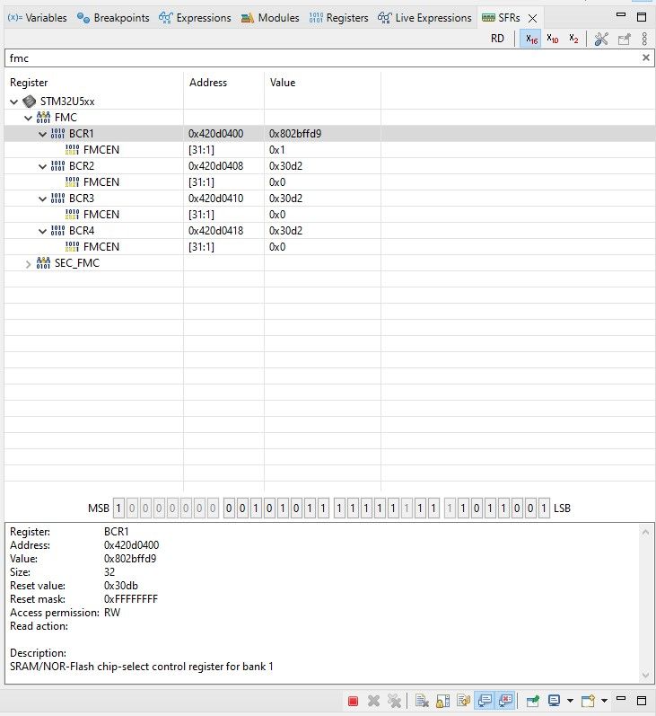

2022-05-28 6:28 AM
I'm not quite sure if I got the things you mean as I'm quite new to the Cube environment, but I hope I found the correct data :) If not, please let me know...
2022-05-28 6:44 AM
Dbl-checked your gpio for control and you have them correct. At least they're same as the FMC example I've passed earlier, of which I know works flawlessly.

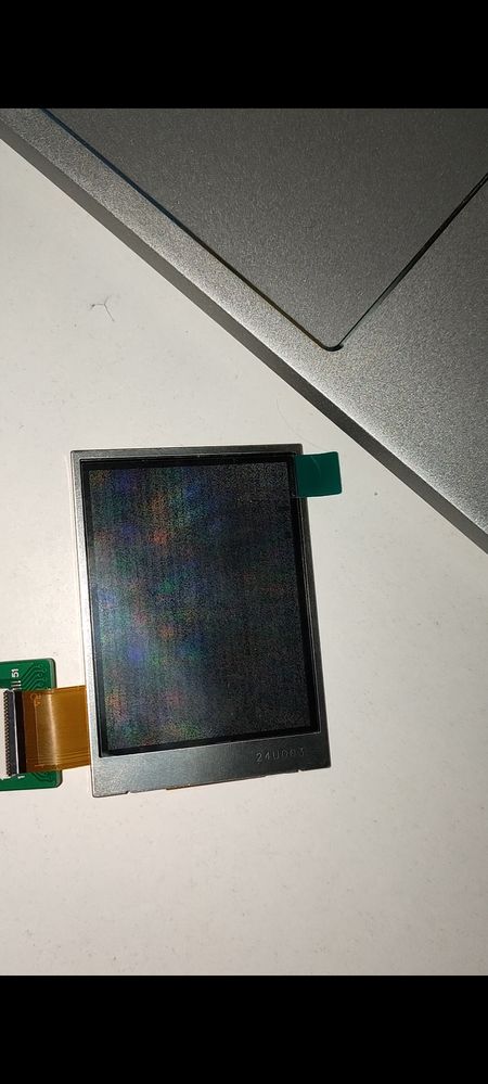

Back to topic: I don't know what I changed - I didn't change anything at all :grinning_face_with_sweat: but: I connected the logic analyzer once again to get any hint for the problem. And somehow all 16 lines work perfectly now! :smiling_face_with_heart_eyes:
I then wired up the LCD again and it at least shows some weird grey pixels.

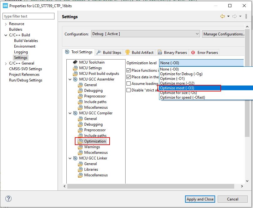

Gooood news!
The screen is running now! It shows different colors and I'm even able to display a jpg image that I converted to a hex-array :smiling_face_with_heart_eyes:
As I said above, I can't really tell what made the FMC work.It just worked from one second to the other.
After adjusting the timing settings, everything is displayed correctly on the LCD.
