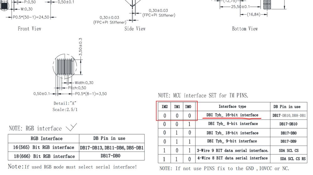

Interesting, let's see that display/hardware. You probably just forgot to set the TFT's interface to 16bits and the thing pulls it down, dunno. For example: one I'm using here requires IM0/1/2 inputs to be LOW for 16-bits. You have the pinout of your display and it's interfacing modes (datasheet) so we can have a look?

2022-05-28 6:11 AM
I used your formular for the address so I'm with 0x60000000 for commands and (0x60000000 + (1 << 19)) for data transfer
I'm having the same IM0-IM2 settings as your screen. I'm connecting all 3 ports to GND. Also I'm connecting DB9 and DB0 to GND as well as all other not used pins (such as SPI-pins for example.
I'm wiring DB17:DB10(LCD) to DB15:DB8(STM32) and DB8:DB1(LCD) to DB7:DB1(STM32). That should be correct I think.
I really think that the problem is on the Nucleo/Code side as I'm not getting any valid output for the Data lines when sending the data for each pixel...
