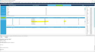

To generate the "MX_USART2_UART_Init();" function, you have to go to your .ioc file->Project Manager->Advanced Settings and unselect the "Do Not Generate Function Call" For the Peripheral Instance Name "USART2".

2024-09-09 5:24 PM
2024-09-09 11:45 PM
