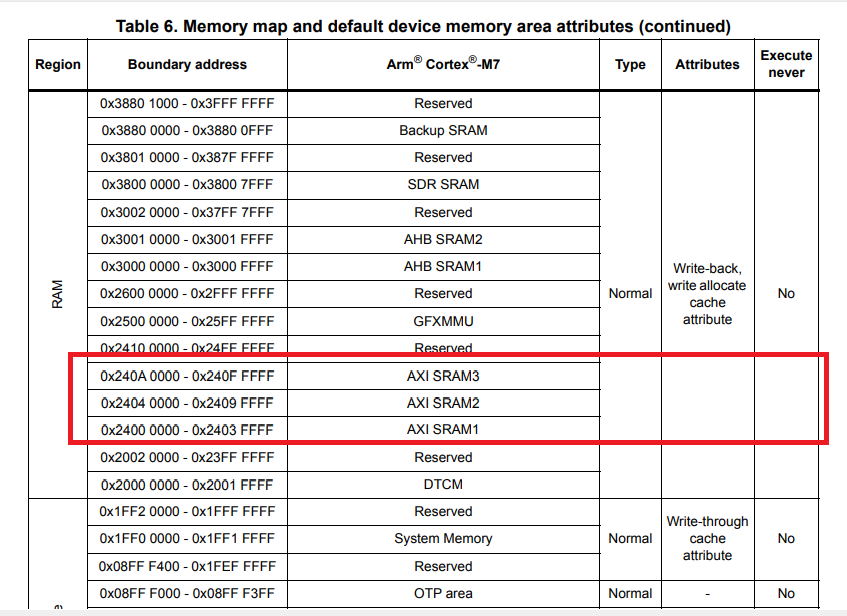

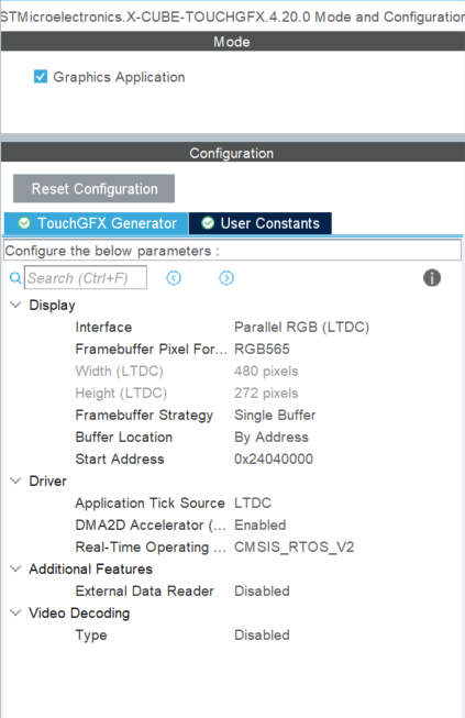

I am doing a single buffer strategy and the buffer location is By Address, starting at 0x24040000 (AXI SRAM2), which can handle 393.216kByte according to the reference manual.

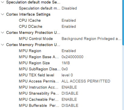

I enabled the MPU region for that region base (SRAM 1, 2 & 3) in the CORTEX_M7.
Using the TouchGFX 4.20.0 software package in the CubeMX, I configured it as follows:

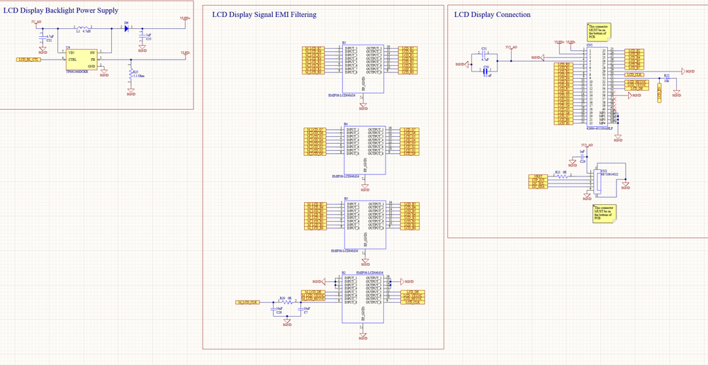

Schematic of my display setup is below.
With this setup, I get a screen flicker on start-up, then a black screen after that.

An update. You were right! The DCLK signal was completely distorted and it was due to those 10nF capacitors. I took the design from the STM32H7B3I-EVAL evaluation board, but I made a mistake. In their design, they used a 10pF capacitor and I put a 10nF by accident.
Dumb mistake! :)
Thank you for helping me diagnose it MM!

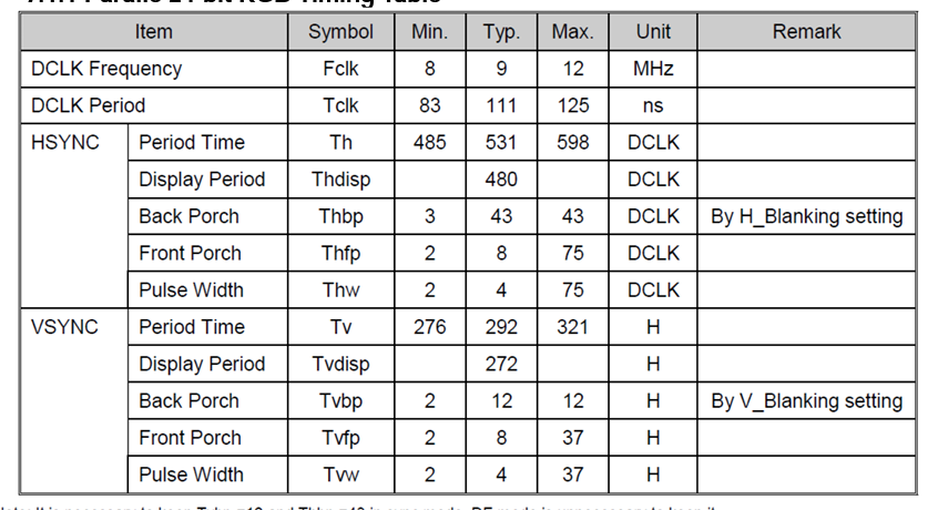

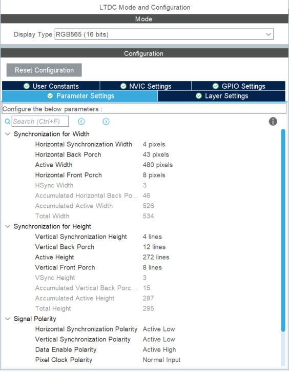

My LTDC clock is set to 9 MHz, as recommended by the datasheet of the display. The only part I'm questioning is the Data Enable Polarity, but I tried both Active High and Active Low, neither worked.

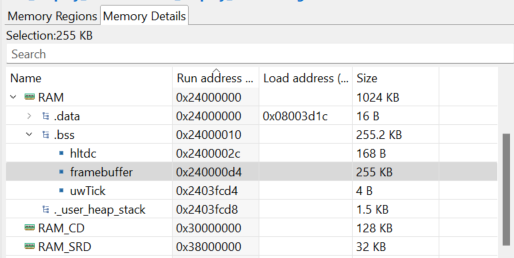

Additionally, I looked at the frame buffer's internal RAM address and they are within AXI SRAM1 and with (albeit tightly) within SRAM1.

2023-03-31 7:28 AM

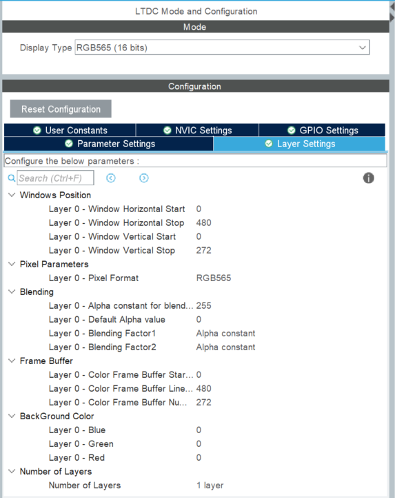

On your config images you need LTDC mode RGB888 if your wires on STM is connected RGB888
Layer FB and TGFX then can use RGB565.
And LCD need first work without TouchGFX.
2023-03-31 7:38 AM
Hello MM.
Thank you for the reply!
I did not know this. Thank you for letting me know!
I changed it to RGB888 and verified the LTDC pins are configured correctly. I get the same result. Screen flickers then goes black.
2023-03-31 7:43 AM
Ok on same screen Layer settings, how address you setup for layer?
You test with TouchGFX or without ?
show main code
TGFX by address cant place framebuffer into RAM, you need modify linker script ...
Try start test By Allocation

As recommended by Romain, I am attempting to get it working without TouchGFX. I am trying to run this test:
Main.c
/* USER CODE BEGIN PV */
uint16_t framebuffer[480*272]; //16 bpp framebuffer
/* USER CODE END PV */

Check your DCLK pin 30 LCD signal with scope. HSYNC VSYNC too.
2023-03-31 8:12 AM
Hello MM,
I will do that! What should I be looking for, specifically?
