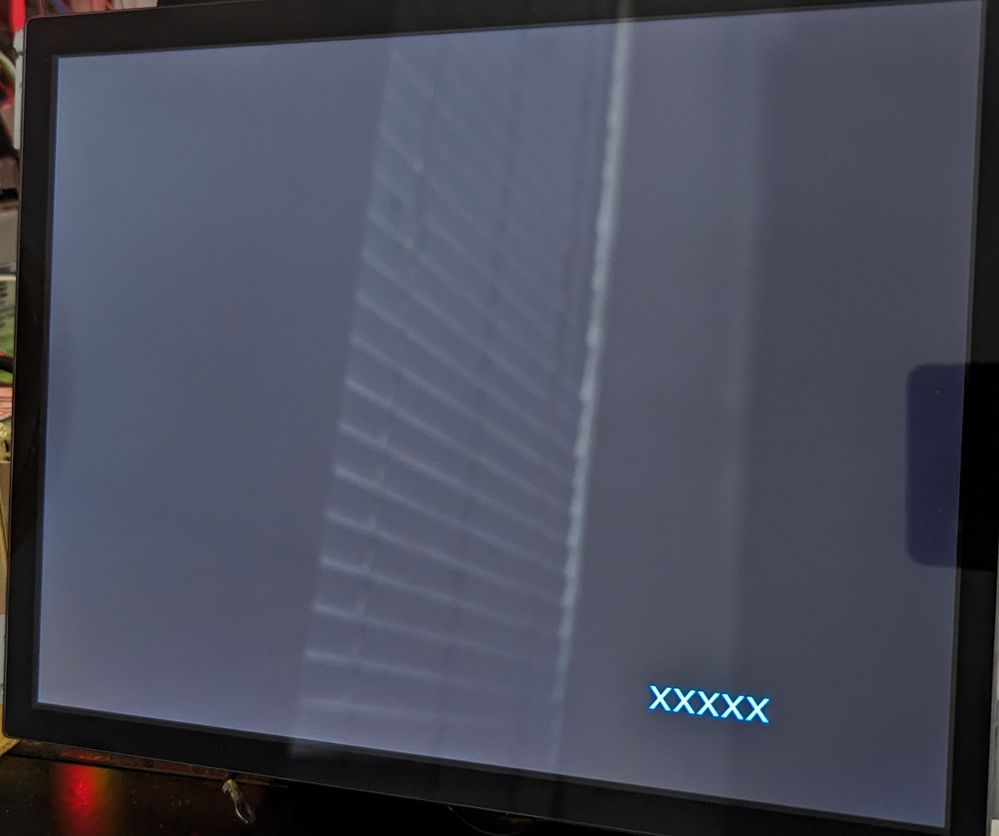

The application starts with the default text ("xxxxxx") in the right place.

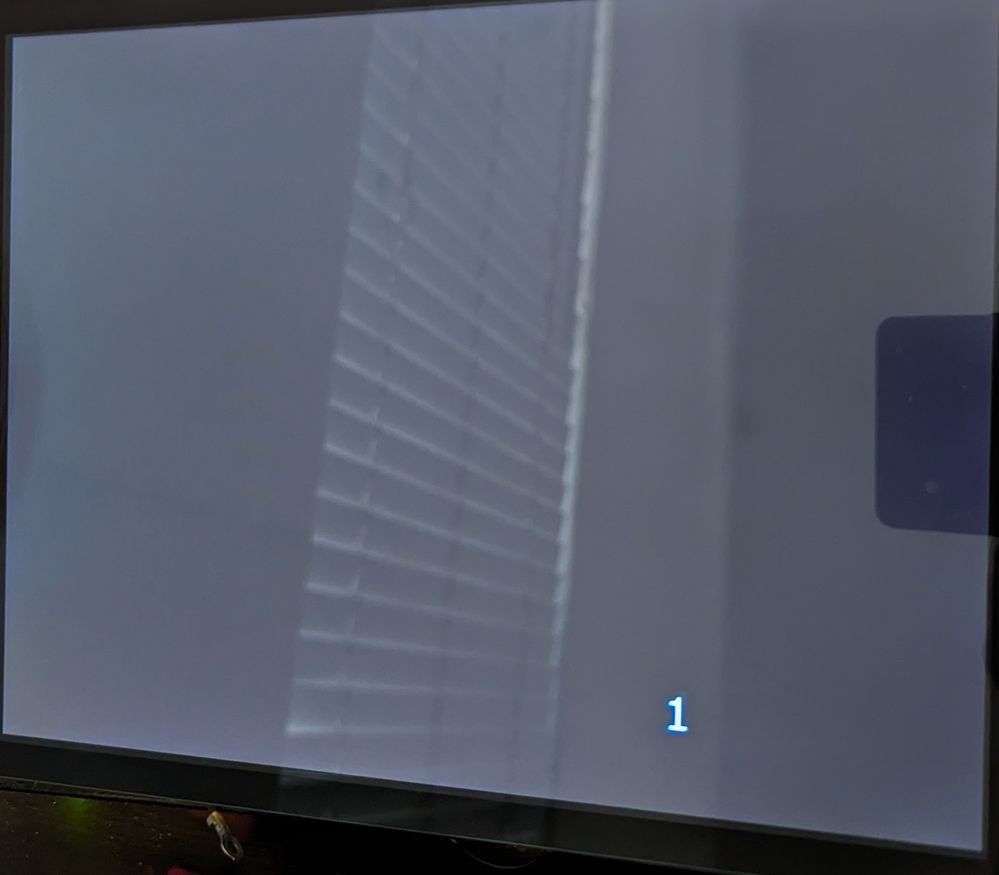

First event, textarea gets updated with the right value ('1') in the right place.

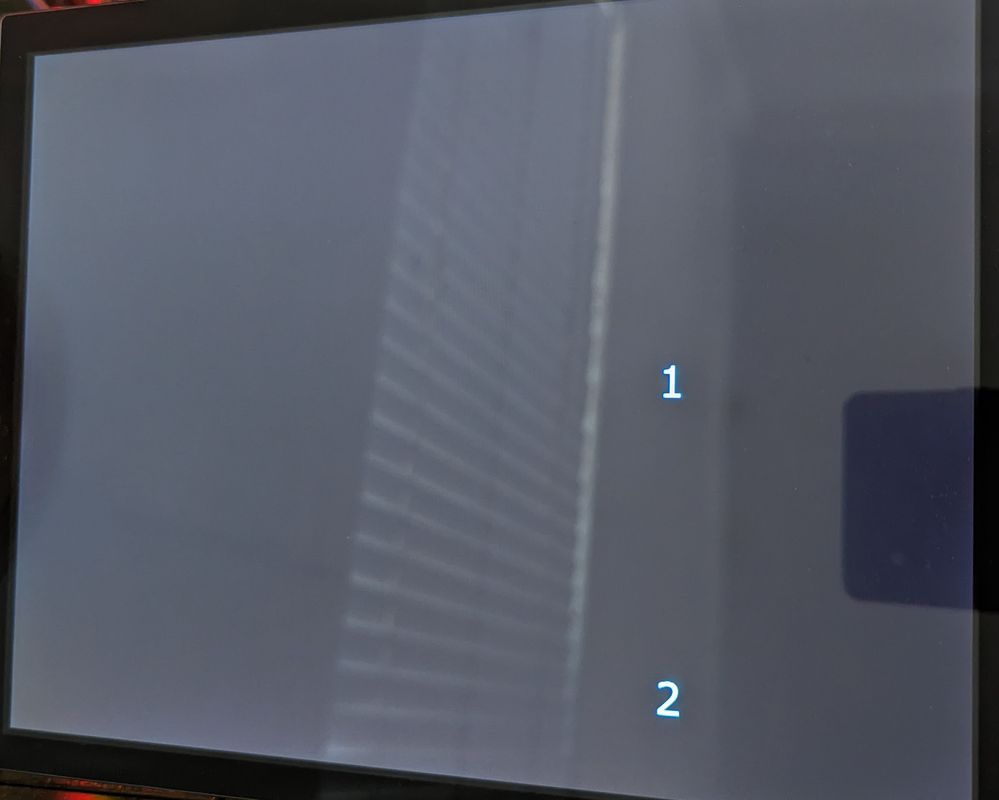

Second event, textarea gets updated with the right value ('2') in the right place but the previous value is also displayed higher on the screen.

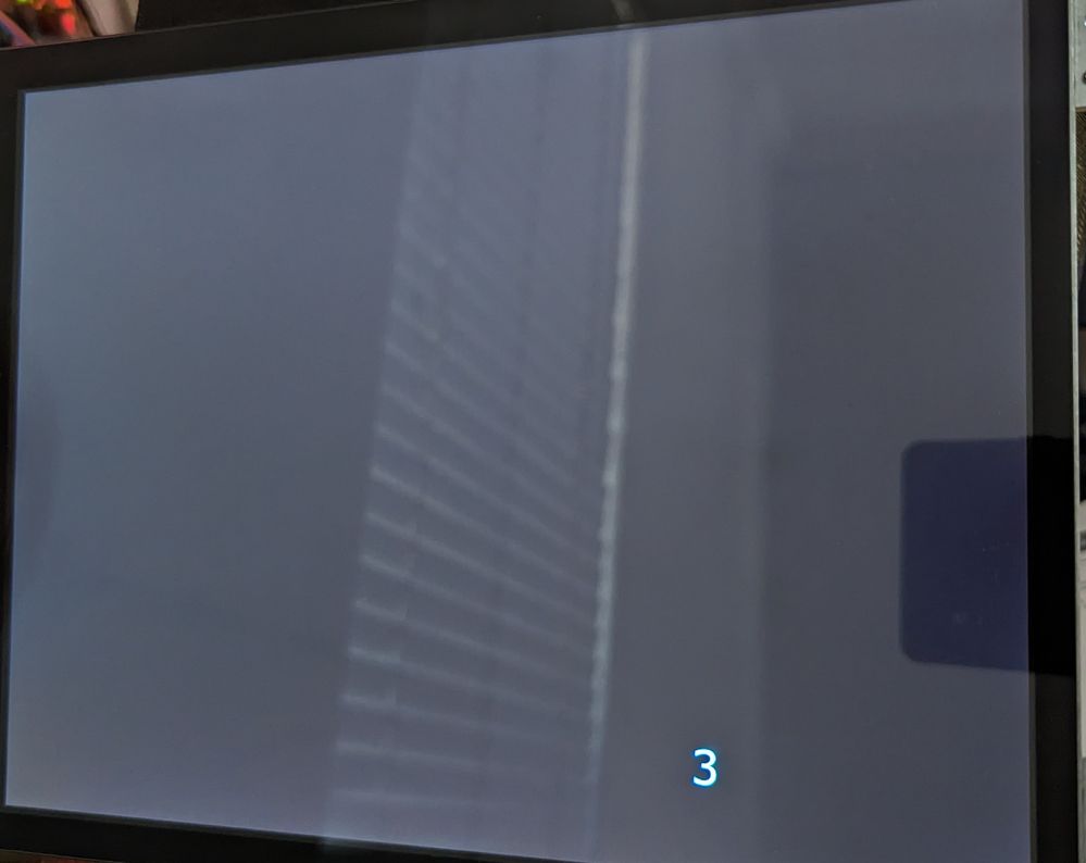

Third event, textarea gets updated with the right value ('3') in the right place and the rest of the screen is blank as it should.

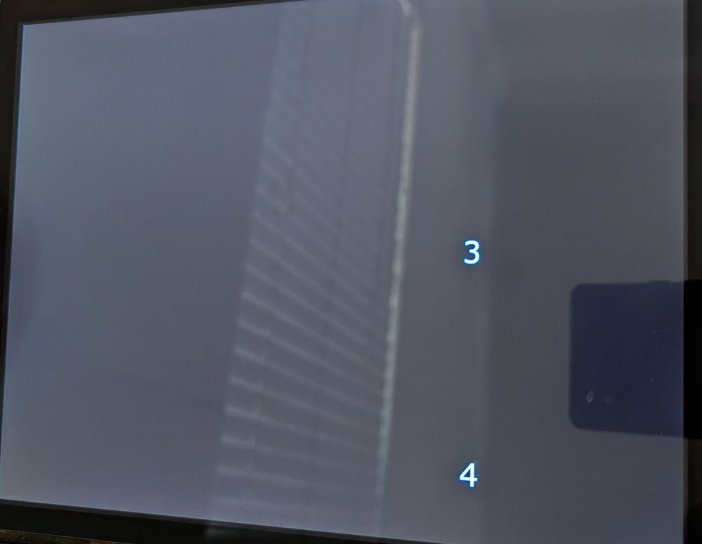

Fourth event, textarea gets updated with the right value ('4') in the right place but the previous value is also displayed in the middle of the screen.
