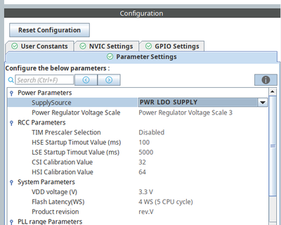

Could an incorrect Power Management Unit (PWR) software configuration (e.g., LDO vs. Direct SMPS) in the HAL initialization cause instantaneous physical damage to the H743 series?

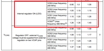

Did you monitor VCAP voltage according to the voltage scale you've already selected in your software? :
Knowing that STM32H743 doesn't feature SMPS. I don't know why are you talking about SMPS here..

about SMPS: here on H743 is no smps , so also no setting, that can be wrong ...
