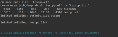

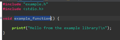

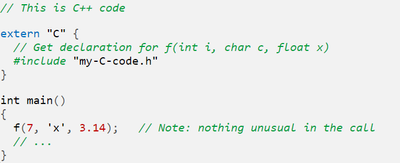

you need to add the extern "c" before you include your header i have tested it and it works fine this is illustrated in the picture bellow you can check this link for more details about mixing c and c++ you will also find a screenshot of the template project with extern "c" addition
the main.cpp
example.h
example.c
BR
