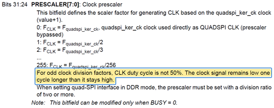

I managed to solve my issue.
I had my QUADSPI clock prescaler at 1 (25MHz QSPI CLK).
Changing this to 0 (50MHz QSPI CLK) or 2 (16.6MHz QSPI CLK) then my QUDSPI data reads got flawless.
From the STM32H743 reference manual:
