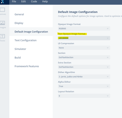

Hello @brbrr ,
I have some doubts concerning your configuration. Transparency should be used with ARGB888 color.
Can you check that and tell us if it helps?
