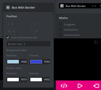

Tip: how did I find it?
Create a flex button and change the background colors.
Go to the ScreenXXXViewBase in "generated" folder and check what was the call corresponding to the color settings:
flexButton1.setBoxWithBorderColors(touchgfx::Color::getColorFromRGB(168, 209, 230), touchgfx::Color::getColorFromRGB(54, 68, 217), touchgfx::Color::getColorFromRGB(255, 255, 255), touchgfx::Color::getColorFromRGB(250, 250, 250));
The two first parameters correspond to the pressed/released background colors.
Hope that helps.
Hope that helps.
