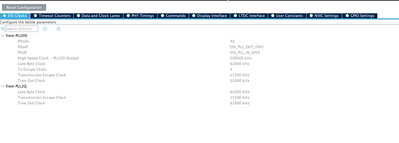

DSI: 62 MHz
DSI txclkesc 15.5 MHz
LTDC: 52 MHz

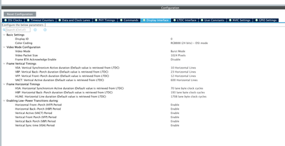

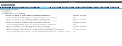

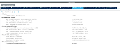

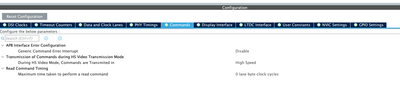

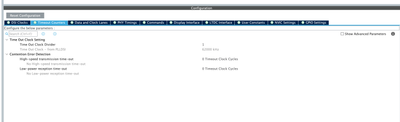

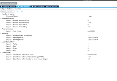

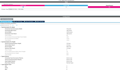

I am attaching images of my CubeMX configuration for:
LTDC:
