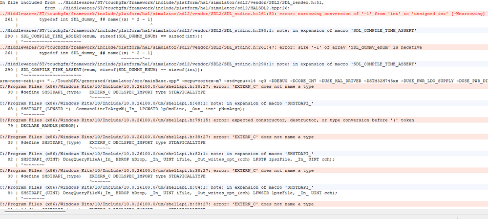

2025-02-10 5:13 AM
Helllo @GaetanGodart ,
Thank you so much for responding on my post.
After i included all the missing paths now i got below errors.
any help would be great. Thanks
2025-02-18 1:25 AM
Hello @bbasnet ,
You should not have any error on code from the framework.
Also, it is weird that the other errors are from a file in windows, not TouchGFX.
Did you change your default compiler or something similar that could cause framework functions to not compile properly and to force the use of some windows file instead of TouchGFX files?
