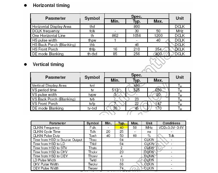

@Alexandre RENOUX I doubt if its 64HZ. I ran small test, I was toggling GPIO pin whenever function Model::tick() is called. GPIO was togging after every 40 mill seconds means refresh rate is 25HZ.
Also got updated datasheet of another Display. We should give as below in CUBEMX. Correct ?
40MHZ clock
Synchronization with horizontal as 1 and vertical as 3,
horizontal back porch 46, front porch 210
vertical back porch 23, front porch 22.
Thanks
2020-07-21 1:14 AM
When you refer to Model::tick(), it's the frequency of the TouchGFX Framework not of the display. They are different even though they should match as best as possible. For instance, if your MCU struggles with heavy graphics computation, the rendering might be longer than 16.6 ms, which will postpone the tick accordingly (I believe it will then wait for the next tick consequently lowering the framerate from 60 Hz to 30 Hz).
Regarding the datasheet, for the porches you are correct. For the rest, I don't know. I'm not the display provider and they are using various names which I understand it's not very clear, but that is the same for me.
