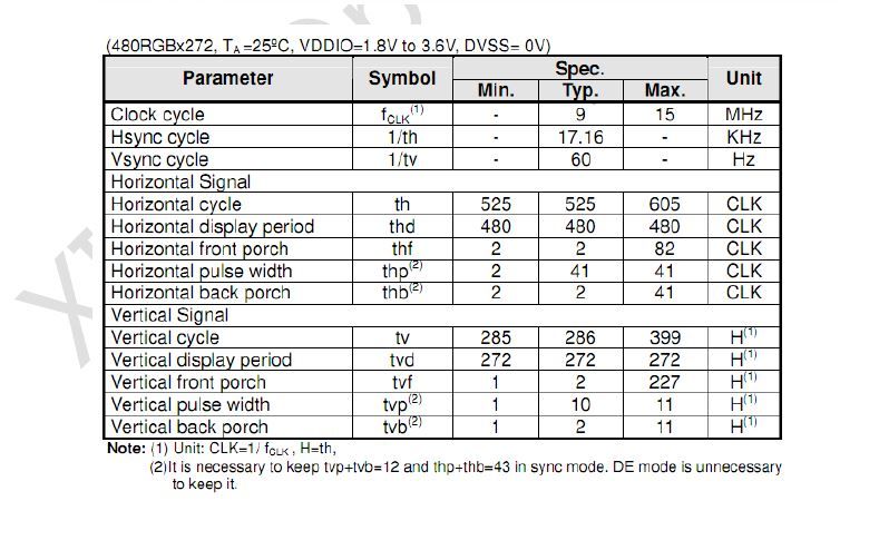

In datasheet X043DTLT is all polarity and timing porch info on page 9.

I checked page 9, but there data is in CLK(HZ) but I need to mention it in pixels for horizontal and lines for vertical. Can you please help me understand it?
2020-07-10 11:55 PM
I looked at the two datasheet and I don't seem to find any relevant info for porch for the 5'' screen 800*480.
On the other hand, like MM..1 mentioned, the screen with a resolution of 480*272px has a table regarding that.
You can see that Horizontal display period = 480 and Vertical display period = 272 which matches the resolution.
Therefore I guess that :
Horizontal front porch is 2 pixels
Horizontal Back porch is 2 pixels
An same for vertical.
Horizontal Synchronization in CubeMX would correspond to Horizontal pulse width and same for Vertical.
/Alexandre

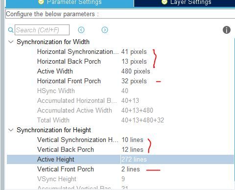

2020-07-11 1:00 AM

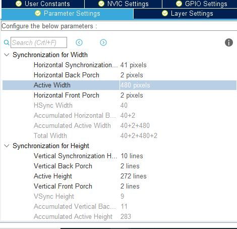

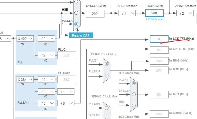

Thanks @Alexandre RENOUX , So you are saying below is correct data for 480*272 ?
My input clock is 9.6 to LCD, but these values ate for 9MHZ.
Also CLK, pixels , lines are same unit?
