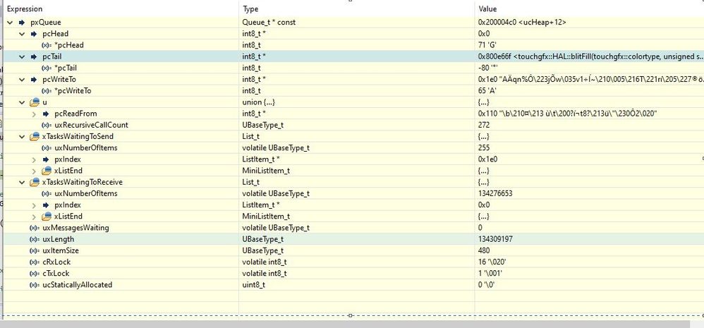

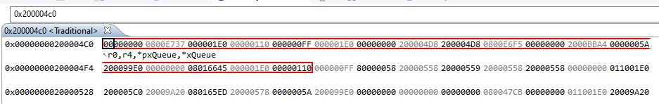

Hello, I have created one basic project with STM32F746ZG and touchgfx. When I ran my code, In starting only its getting stuck at freeRTOS function vPortRaiseBASEPRI. After debug I found that code asserted at below line of function xQueueSemaphoreTake of queue.c.
/* Check this really is a semaphore, in which case the item size will be
0. */
configASSERT( pxQueue->uxItemSize == 0 );
This function is getting called by OSWrapper.cpp function tryTakeFrameBufferSemaphore. Here we are trying to take Semaphore "frame_buffer_sem". So in simple words value of frame_buffer_sem. uxItemSize is odd like 480.
When I debug more, I found during initialization(OSWrappers::initialize) of Semaphore has all correct values but seems like after sometime its getting all data corrupted.
I am really not sure how heap memory is getting corrupted as I just generated code from touchgfx and STM32CubeMX. My heap size is 32768 bytes.

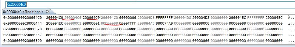

Below are the screen shot of memory allocated for Semaphore "frame_buffer_sem"
After Initializing:
At function tryTakeFrameBufferSemaphore call:
Note : 0x200004c0 is address of Semaphore "frame_buffer_sem" .
Clearly heap data is getting corrupted.

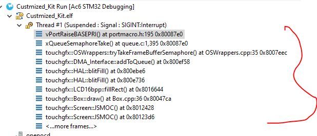

Below is the stack level
Any help?

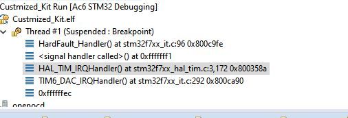

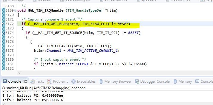

Post changing to NoDMA I am getting hard fault due to TIMER6. I am not using TIMER6 any where. Does Touchgfx needs it?
Last trace is highlighted line

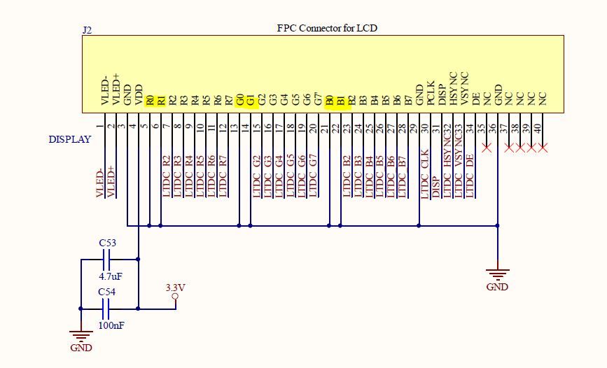

Btw now i am using RGB565 format so below is my new LCD Connector schematic. Please check if this is correct.
2020-07-10 4:14 AM
Is this due to HorizontalSync, VerticalSync, porch ? How should i get correct value of these parameter as unable to find it LCD datasheet.
