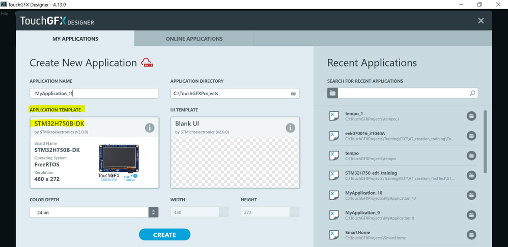

That video is a bit outdated. Why don't you just create a project from TouchGFX Designer with the right application template corresponding to your board. Then when you generate code it will provide you a cubeMX project. All the CubeMX configuration is done for you. Each application template contains project files for GCC, CubeIDE, IAR and Keil.

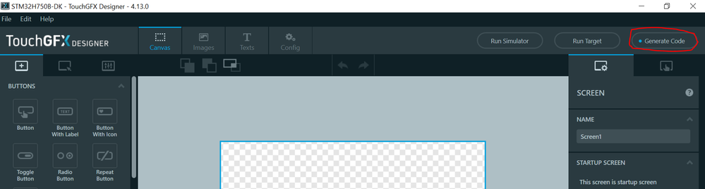

When you create a project from Designer you should select the right Application Template, so in your case the H750B-dkThen click on the button Generate in the top right corner to generate all the files for you project.

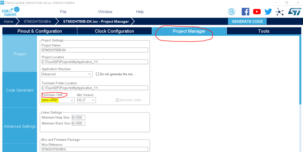

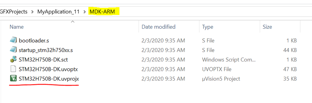

Now if you go to the folder where you created your project you will see a MDK-ARM folder, this is where you will find the Keil project. But first you should open the ioc file (cubeMX project) to set the right toolchain. When you open the ioc file and arrive in CubeMX, go to the project manager tab. In the section "Toolchain / IDE" select MDK-ARM and then save (cntrl S) or generate code. This step is necessary when you change toolchains/IDE, and the initla IDE set is STM32CubeIDE
You can now debug/run your project with Keil by opening the uvprojx in the MDK-ARM folder in your project folder.
