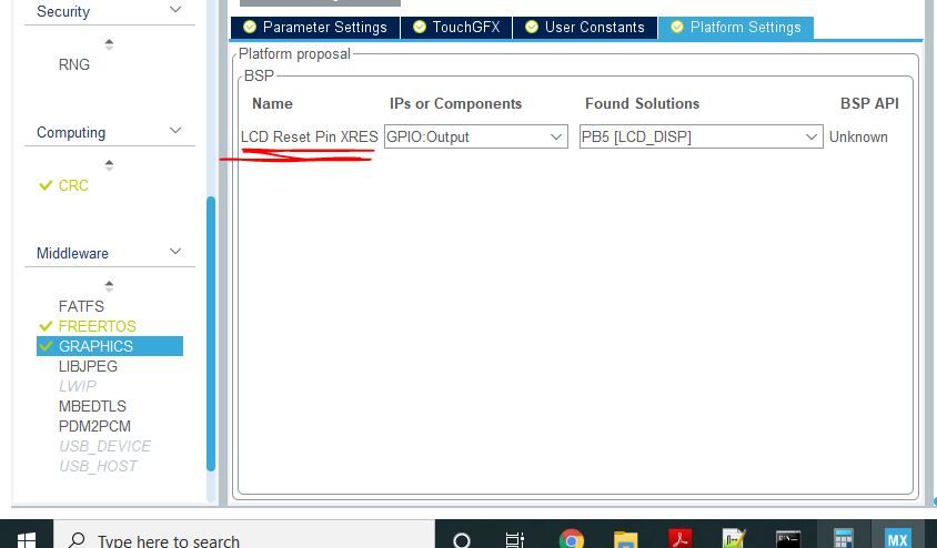

I think 64Hz i need to set somewhere in Touchgfx but unable to find correct location, Can you help ?
Also in Touchfgfx I need to set LCD RESET PIN XRES but there is reset pin in LCD.

2020-07-13 1:52 AM
@Alexandre RENOUX
Also in Touchfgfx I need to set LCD RESET PIN XRES but there is reset pin in LCD. Can you suggest.

When you dont have reset on LCD simply set unused port pin here.
