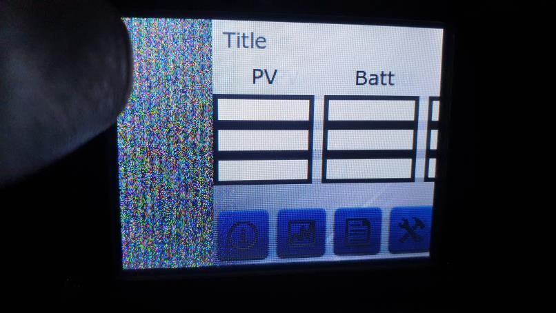

I am having an issue with transitions between screens. I’m using a cover transition but as soon as the transition starts the background turns to noise however the new screen covers it gradually as expected.
The program is running from QSPI flash on a stm32h750 dev board with a LCD connected to the FMC. The double frame buffers resides in the internal AXI sram.
I have tried adding an animation buffer also in the AXI sram, but it had no effect.
Has anyone had corrupted background like this or can recommend something I should check?

I had some success!
If I set the entire AXI sram to 0s on boot, instead of noise in the background it is all black. It's like the second buffer isn't getting used except when transitioning. Maybe it’s a bug with TouchGFX? i'm using 4.17.
After changing from double buffer to single the problem goes away and everything looks as it should.
Anyone else had problems with double buffering?
