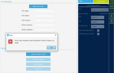

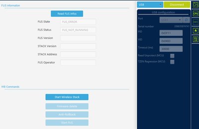

In some cases, FUS reports FUS_STATE_ERR and FUS_NOT_RUNNING (USB-READ-FUS2.PNG).

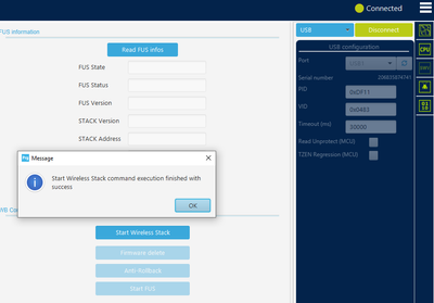

Even when a command reports "Success" in the log (USB-START-WIRELESS2.PNG), the operation has no actual effect on the device state.

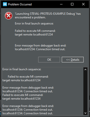

Because of this deadlock, STM32CubeIDE cannot establish a connection:
Error: Connection timed out (localhost:61234). The GDB server is unable to halt or communicate with the core.

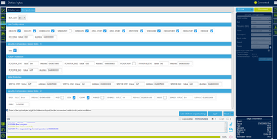

I have also attached my current Option Bytes configuration to see if there is a conflict in boot settings or memory protection that causes this deadlock. Any advice on the correct OB values for FUS recovery would be greatly appreciated.
Note: RDP is AA.

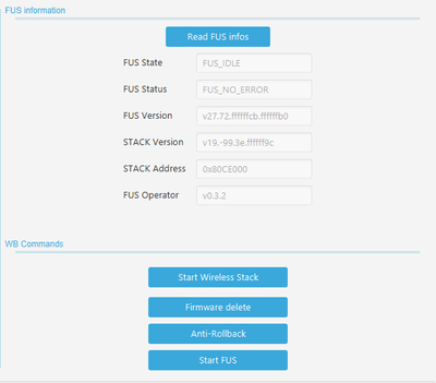

When I click "Read FUS infos", I see the following as shown in the image:
FUS Version: v27.72.fffffcb.fffffffb0 (FUS Operator: v0.3.2)
STACK Version: v19.-99.3e.ffffff9c
However, when I try to "Start FUS", I get the FUS_STATE_ERR_UNKNOWN error in the logs. The same thing happens when I try to "Firmware delete".

Did you check the value of the SFSA and SBRV option bytes?
2026-03-25 1:24 AM
SFSA = 0xCE, Address = 0x080CE000
SBRV = 0x33800
