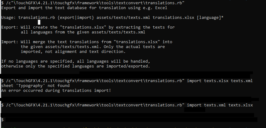

2023-02-06 8:32 AM
Could not be the problem in swapped .xml and .xlsx extentions in your command ?
Here is what my system shows:
Also, my conversions run without .xsd file present.

2023-02-06 8:32 AM
