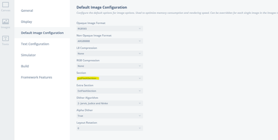

By default images are located in external RAM in TouchGFX.
You can change the default region from the "Default Image Configuration" panel in the "Config" Tab, or individually every images in the "Image" Tab like this :

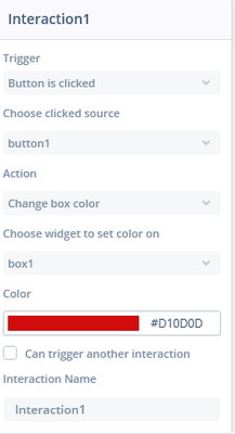

You can alternatively try to add a box to your application and configure an interaction like bellow, just to see if the coordinate of your touch are correct and that the button actually can trigger something :

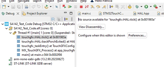

Looks like I am actually always getting a HardFault upon touching the screen (not just when I enable DCACHE). If I run my debugger and set my breakpoint within sampleTouch the I2C Receive works and the X_Touch and Y_Touch coordinates are read successfully, but once I step past that function I see a "No source available for touchgfx::HAL::tick()" then it enters the HardFault loop.

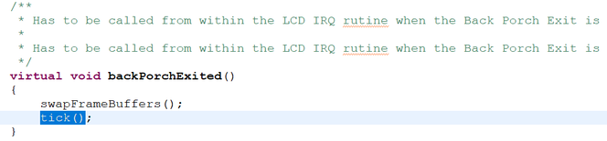

This tick() looks to be called from the HAL.hpp backPorchExited() function
When I do not touch the screen, and set my breakpoint here this tick() function gets called periodically and runs without issue. Do you have any suggestions on what could be causing this? I've been looking around the forums and haven't found anything that has helped.

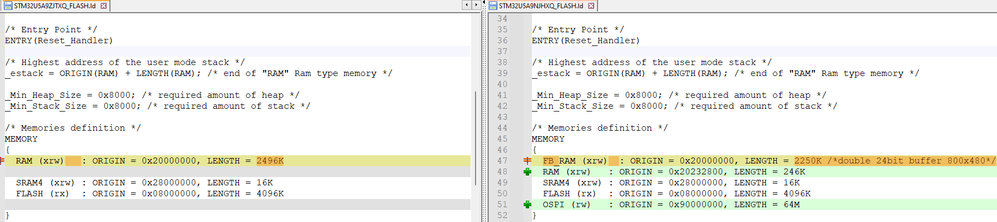

One of the things I missed in getting my CubeMX generated project ready to interface with TouchGFX were the STM32U5A9NJHXQ_FLASH.ld and _RAM.ld files
^ my custom PCB project's FLASH.ld file is on the left and the working demo project on the right. Was missing some configuration for the frame buffers

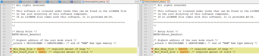

^ ram.ld file was missing larger heap and stack size
I copied over the differences (hoping the difference between the NJHXQ and my ZJTXQ doesn't impact the flash and ram... does it?). The system now responds to my on-screen button presses; however, the screens have now gone black. Only the Box elements are showing up.

Thank you Osman for the resources and insight about where to designate the storage of the TouchGFX images! Switching the Default Image Configuration section to Internal Section fixed the black screen issue. Our board actually does not currently have external flash but we will likely be adding it after reading through the memory documentation.
