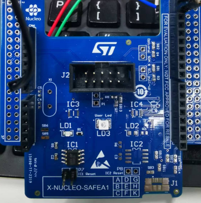

I have the project with the chip STSAFE_A110
I don't need to development the application
I just need to confirm the hardware is ok, for example, obtained the sn of the chip is successfully or other way
I don't want to add the stsw-safea1-mw to my project, There's no other easy way?

Or are you just looking for help to make a small test application that reads the serial number from STSAFE? On which eval. board?
> Yes,that is right.I just need to confirm the hardware is ok by read ID or serial number or other
2024-04-23 5:11 AM - edited 2024-04-23 5:11 AM
This is possible without the "middleware" libraries. You just can check that HAL_I2C_IsDeviceReady succeeds to be quite sure that the device is responding. Then find in the documentation how to read the serial number and just do it. Hopefully this can be done using HAL_I2C_Mem_Read or HAL_I2C_Master_Receive, without any crypto voodoo. If this still sounds too hard, please see above. Make it Someone Else's Problem.
