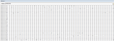

Sorry, for context we are developing a display pipeline, LTDC reading from two SDRAM framebuffers, configured to drive a DSI wrapper and host to send via adapted command mode to a CO5300. I have to debug frequently, obviously, and can get register values from all other peripherals (DSI, RCC, FMC, etc) that make sense.  Except for LTDC.  Whether I look at that in system viewer, if I grab them in code and print them out over UART, even if I look at the values in memory viewer starting at the LTDC address (0x50001000), I see LTDC register values that don't make sense. Most often all zeroes, but sometimes the same random (?) value in each register.

I ran the example: Projects\STM32H745I-DISCO\Examples\LTDC\LTDC_Display_2Layers provided in STM32CubeH7 on STM32H745I-DISCO and checked the address 0x50001000 and nothing special occurred:
There are some values are changing but I think this is normal: some internal registers are changing according to what the application is doing at run time and what the current status of the LTDC registers, but didn't see at any time that "all zeroed" LTDC region or that "?" character.

Thank you for checking that.  My coworker learned that we can see the LTDC registers before we enable the DSI wrapper, but not after. Very strange, I can't find anything about this.  At least we can view them now, but I'm worried that indicates some deeper problem...
