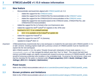

Hello @SharonVEC
Can you check with the new STM32CubeIDE version 1.15, it integrates the GCC 12 as default toolchain, newlib-4.2.0

Sorry for my late reply.
Thank you very much for your response, I was skeptical but upgrading the toolchain to 12.3 rel1 removed the vulnerability issue.
