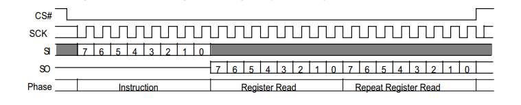

this is the first time i have used QSPI library, I have to use external flash in QSPI mode.
In the data sheet it is given that, CS# pin should be low until command instruction 16bit data will pass. as shown ablove.

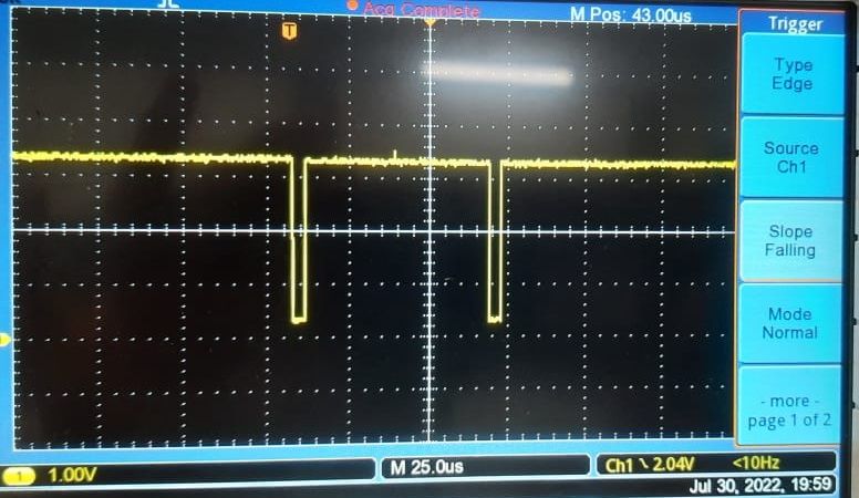

but when executing command the CS# Pin perform HIGH-LOW_HIGH and again did the same thing at the timing of writing. this should not happen. asper data it low at command insertion and data writing.
ihave check ON CRO.

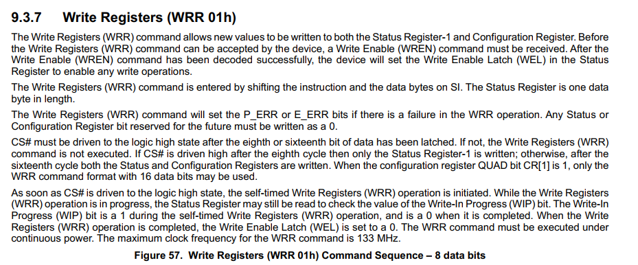

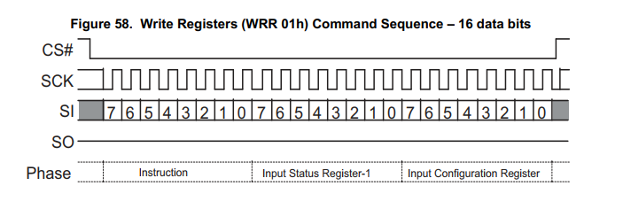

For enabling the QSPI mode, you need to set QEN bit of configuration bit and for that you have to send write enable command followed by 16 bit value of status register and configuration register. In that sequence CS# should be low.
given in data sheet. i have attached screen shotbut when I write code for enabling command given below

}the CS# pin get two time HIGH_LOW sequence, where in datasheet(screen shot above) it should be done in consecutive.
CS# pin screen shot for enterQPI mode.i think because of this i am not getting proper result, so if I manipulate CS pin, result would be proper. correct if am wrong .

The screen shot of the scope lacks any contextual data. Really need clock+data
To write the registers you'll be needing at least two commands, so two NCS pulses.
Presumably a Write Enable, followed by a Write Register(s), and potentially a Polling for BUSY in situations where the write goes to NV or OTP which operates more slowly than combinatorial logic.
Also you might want to read the current register settings, only setting the bits of interest, and when necessary, rather than blind writing.
