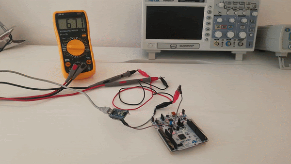

Check VDD at Jumper JP6. Check at the connector that BOOT0 is low and NRST high. You can re-connect the cut-off ST-LINK via PA13 PA14 and GND and check/debug/program your board via ST-LINK.

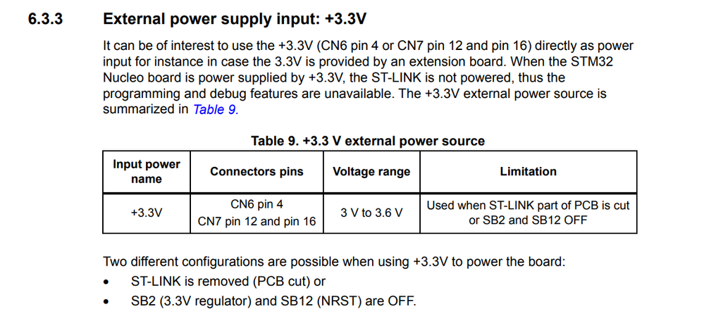

- VDD at Jumper JC6 is 3V3 (SB2 is Desoldered to isolate the LDO)
- BOOT0/R33 is 0V and Connected to GND. NRST is HIGH.
- The Board works as expected when its powered by 5V VIN, E5V or STLINK. As soon as its changed to 3V3 it stops working.
I would also like to mention that my colleague was able to independently verify this 3V3 issue. I believe he received the dev kit from the same production batch. He was not able to get anything of 3V3 working.
Thanks, Gurbir
2022-07-30 7:03 AM
Hey,
I have isolated the MCU from ST-Link by Solder bridges and cutting the top part off. The LDO is also Isolated, I am still not able to get it working with 3v3. Thanks
